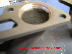

In this "before" picture, you can see
the inside "lip" we are talking about.
Remember, a little does a lot here !

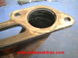

"After", you see how the "lip" has been
ground away and "blended" about
5/16th of an inch back into the pipe.
